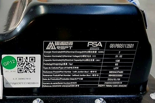

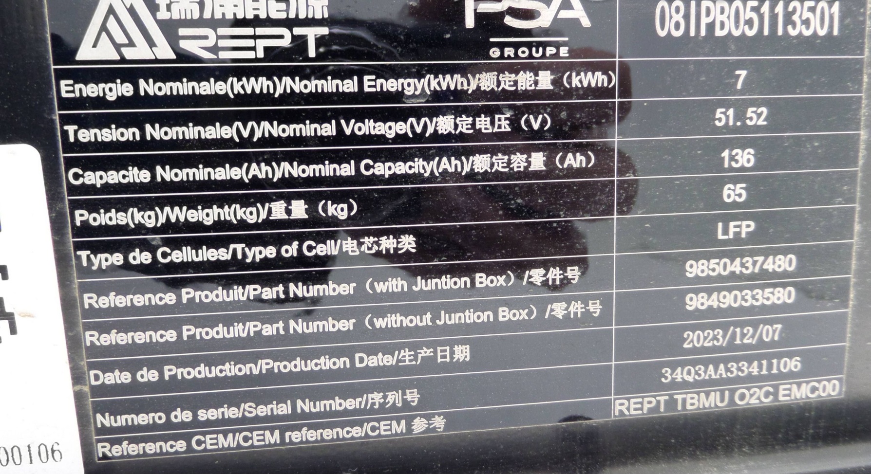

Hello,
The battery is LFP, and now 7Kwh.
Hello,
Found some info from used LFP battery for sale. It seems that it is 7kWh and not 5,5 kWh as communicated in the manuals and most web pages. It is 51,52V, and consist of 3,22V modules. The advantages of this REPT battery that it is more robust and can take up to 6000 cycles or more before the degradation reaches 80%, but the cold temperature performance is not as good as in the NMC version used up to 2023. Especialy at any sub 0 temperatures.
